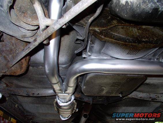

With that in mind I'm going to a single 3" three stage cat Monday and eliminating those 4 cats completely !
I did this on the Bronco and I gained 3 mpg and a boatload of torque ! The thing barked em' going into second for the first time ever.
We figure I'll get an even better increase with the Town Car, as it had four, not two cats to pump through.
Before you call me insane, check out the kind of Y-pipe I built last time for the Bronco;

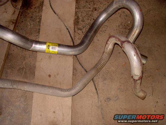

Posted by: Sixlitre
Well I done did it (redneck grinning)

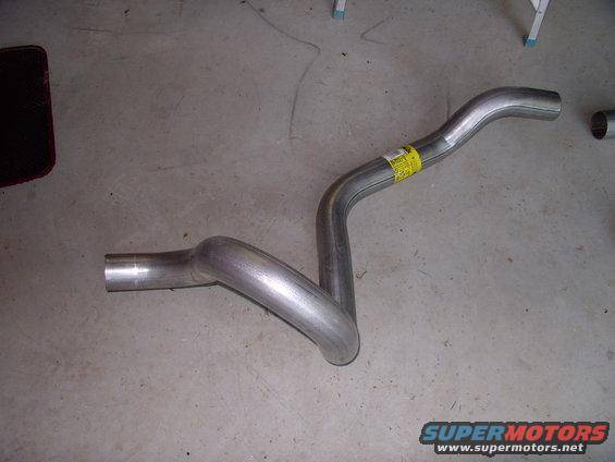

I plunked down $40.00 CDN for this Dynomax mandrel bent 2 1/2" tailpipe;
Even not counting the mandrel bends, the flow capacity increase is 56% over the stock 2" tailpipe;
I need it to help evacuate my 3" Y-pipe and 3" cat;

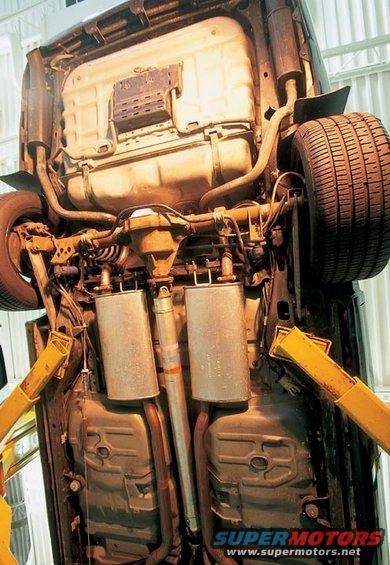

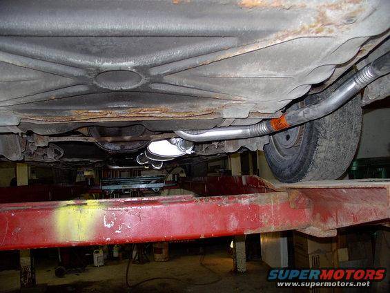

The tailpipe gets us up and over the axle, round the airbag and clear of the tank and sending unit beautifully, as seen in this photo of a CV (guy is using stock Chev 2 1/4" pipes);
Only thing is the tailpipe peters out, right where the guy had welded in the resonator style rear mufflers.

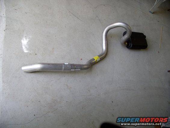

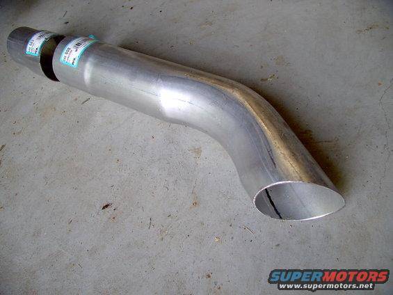

They don't thrill me and neither does chrome or 5" ricer style fartcans, so....... I decided to make up the remaining @22" with a 2 1/2" to 3" reducer (okay increaser) and this 3" turn down/extension;
So far I haven't busted $50.00, but the Hooker AeroChamber 2 1/2" muffler arrives tomorrow.

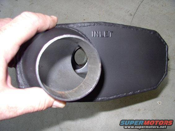

Posted by: Sixlitre
Picked up the Hooker Areochamber muffler today;
Supposed to "kill" ALL Flowmasters on flow rates, yet it won't drone at cruise, like so many Chev trucks do;

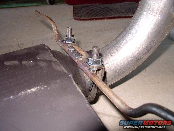

Gonna use the this little set up to hang it from the stock Lincoln rubber isolater/hangers;

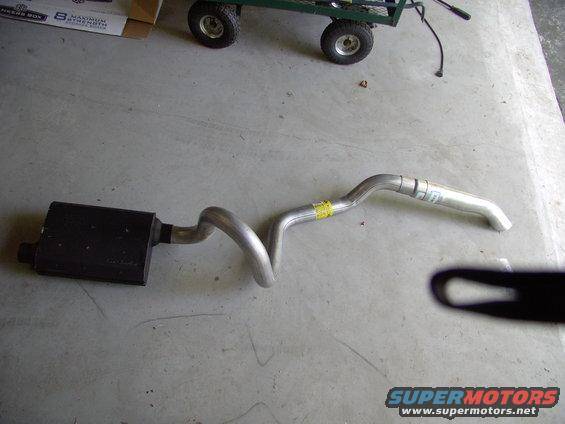

No sense in reinventing the wheel. Coupls of shots of the "Sixlitre catback system" so far;
2 1/2" Hooker Areochamber muffler into the Dynomax Impala SS mandrel bent 2 1/2" tailpipe, increased to exit through the 3" turndown (which also makes up the needed 22" of extra tailpipe);

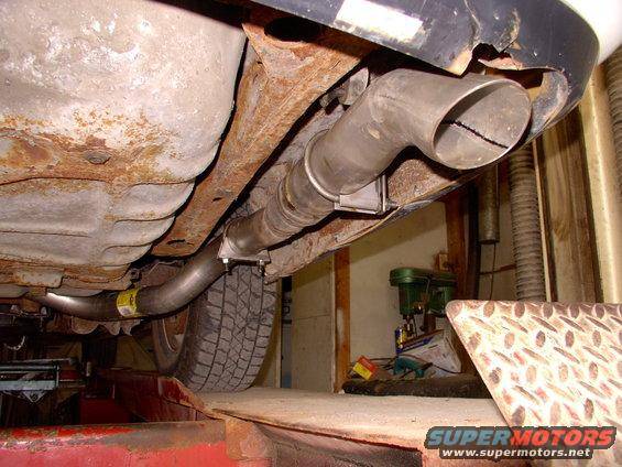

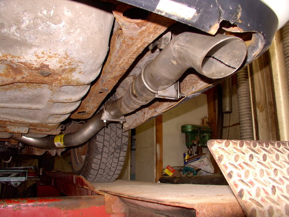

Posted by: Sixlitre
I was under the Lincoln today with my pipe bending buddy. We finished a "Sixlitre catback" for the 5.0 litre 90' Town Car;
Used a Dynomax Impala SS 2 1/2" mandrel bent tailpipe (@$32.00);
The new Hooker Aerochamber muffler, like BRBuzz151 found outperforms Flowmasters(http://www.fullsizebronco.com/forum/... aerochamber);
Major improvement over the stock 2" crimped/kinked tailpipe;
Really felt more power and acceleration afterwards. Upshifts seem effortless and the mileage (on the computerized dash at least) is up several mpg at every stage; accelerating, cruise, etc.
It now sounds like a Ford smallblock and burbles on start up and at idle, yet there's no Flowmaster drone at cruise. Nail it under a bridge and you can hear it no troubles.
Here's the link to the install pics;
http://www.supermotors.net/vehicles/registry/9371/58990

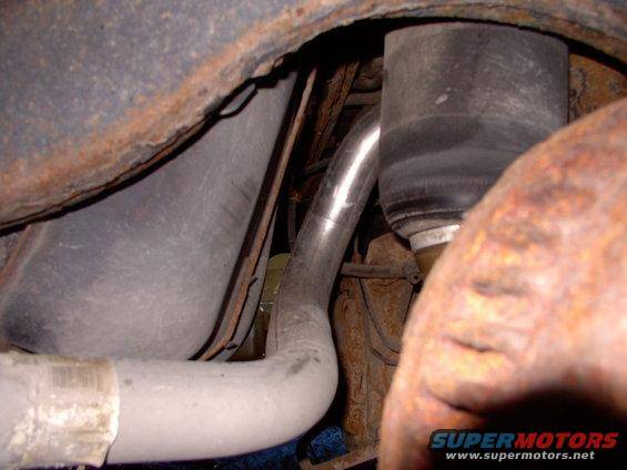

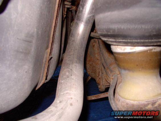

Worried about gas tank clearance ? No need;
