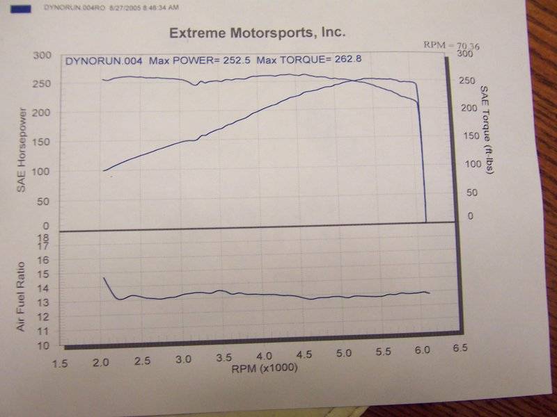

The tune gained 15 HP and 15 LBFT or torque over baseline.

driller - that's really cool. what gear did you run in for the dyno results? Second?
Posted by: driller
Quote:
Originally Posted by 67Continental
...what gear did you run in for the dyno results? Second?
They lock it in third(1:1) for the pull.

That supercoupe has a 3.8L V6 and even without nitrous the car managed to put out a max of 274HP and 340ft/lbs at the rear wheels. The injectors were close to being maxed out so no run was made on nitrous. He's going to have to upgrade the fuel system. Even still, as it sits, it's a mid to high 13 second car. He gained 12 HP with the tune. Of course, he has a lot more torque than a Mark VIII.
As far as cost, it's not cheap. Dyno time will run you about $100 average, and you'll need a chip with the tune which I think goes for like $350. Even with a SCT chip already on the car, you're talking $250 minimum.

Advertised power is usually measured at the flywheel.
A car will have anywhere between 15-20+% power loss through the drivetrain because of friction.
His numbers are at the rear wheels.

Posted by: driller
Quote:
JP, your saying the dyno tune ousted the chip on the dyno? If thats the case I hope the comparison runs were back to back, if not then the results are flawed.Too many variables will affect the outcome, humidity, baro, temp...etc.
The first run on the rollers netted like 237 HP and torque in the upper 240s. This was with the switch chip in the 'Race" position(same as I had when the car ran a 13.99 the prior weekend). That program was copied and modified and then flashed to a separate switch position. A couple more runs to tweak the program and then a final run after a 15-20 minute cooldown and a final flash.
What I did not realize until later, I needed to ask for a 'comparison graph'.

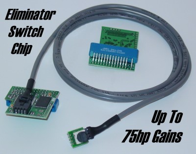

Posted by: driller
Quote:
You have a chip with selectable programs? Are they selected through a switch in the car?
Yes, it is a small rotary switch. I mounted it through a drilled hole under the dash in the removable trim beneath the steering column. You can have 5 programs - one being the stock program.
* - 75 HP in diesel chip only
Product Name :
SCT 6600 4 Program - 4 Bank Chip EEC-IV and EEC-V ELIMINATOR SWITCH CHIP
Product Description :
Six Function, Four Program - Four Bank Chip
User selects one of four programs via a dial 0, 1, 2, 3.
Program 4 is the FACTORY STOCK
Programs 5, 6, 7 NO START
Geno, do you now sell 4-bank/5-program switch chips?
Posted by: ONEBADMK8
I can get milti-program blanks sure.
