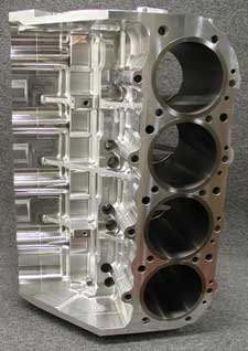

Does anyone know how this compares to the teskid block? and it says 2v replacement but being modular it should work with 4v heads to correct?
Posted by: Grifter
willing to bet it is an explorer block..
i think everything fits, you just need to tap a couple holes IIRC
Posted by: klutch
any idea how strong it is I need this thing to handle 500HP+ maybe more later on no more than 800HP tho
Posted by: evillally
That's the "Mountain Block". Capable of 1500+ horsepower easily...

Yep. They are the current Windsor aluminum blocks. Karkraft usually sells them new and used...
Posted by: klutch
Quote:
*Note: above Mountain Block is no longer in production. Our inventory is almost all gone-
Don't Wait!!!
hopefully my wallet permits getting one before they run out
