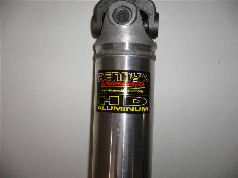

And this is what the guy bringeth me.
This is one LITE driveshaft. I'd give it about 12-14 lbs if that. I feel like it will break if I handle it too much.

I thought Dennys sent me the 1350 Series??????????????
How much torque will the 1330 take? I wonder if it will live with ~500 Ft. Lbs...
Posted by: 94m5
Yea...they will live under 500+. 1330's are plenty for your average hodrod lincoln. 1350's are for 700+ with traction. You'll twist the half-shafts before you break the 1330's
