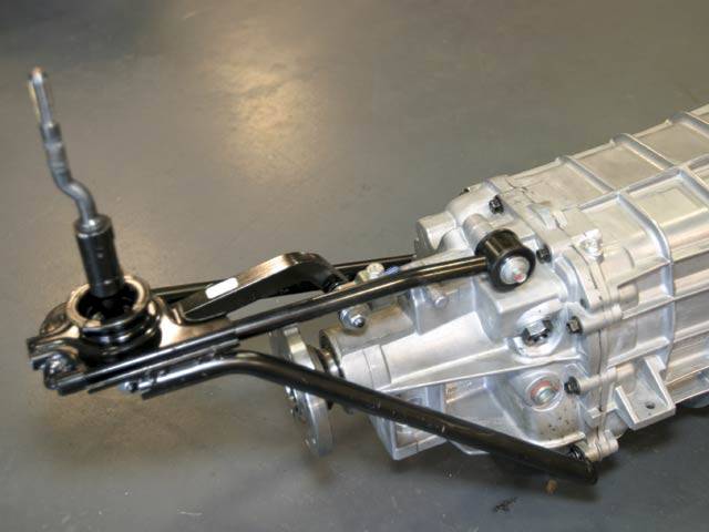

The T45 is what I went with because it was cheap, and there are ALOT availible. I wish I would have went with either the stronger 3650, or just put the T56 I have sitting for my 95. The syncros and input shaft bearing are weak in the 45, and mine is making a hell of a racket. I say only use the 05+ 3650 because it is already designed for a remote mount shifter and needs minimal fabrication to fit the Marks.
Both the T45 and T56 need extensive mods to the shifter linkage and housing to extend them back to fit the stock hole in the console. This includes TIG welding a new housing on the back of the tranny, and welding a new shifter rail to fit. Pics will be posted at the bottom of this. If I were going to do this, I would use the t56 as it has the taller overdrive gear, and can support 4.56 or higher gears and still have a low cruise RPM.

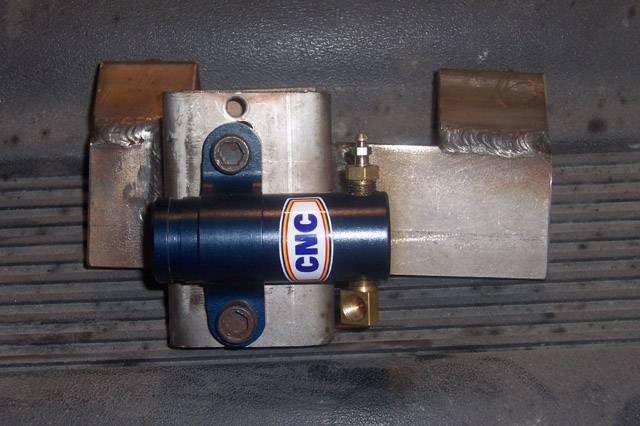

The release mechanism has different options also. I went with an external "push" style Slave cylinder and a willwood 5/8's inch master. The cluch pedal is out of a 94 thunderbird supercoupe, and had to be modified to fit the mark. I also had to have an adapter machined out of aluminum to fit the willwood M/C to the stock pedal. Pic of that comming up also. Another way is to use the same master setup, but use a McLeod slave cylinder/T.O. bearing assymbly. This cuts down on required fabrication, but costs alot more. I have thought about using a stock mustang cable actuated clutch, but decided aginst it.

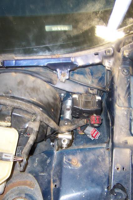

ECM relocation

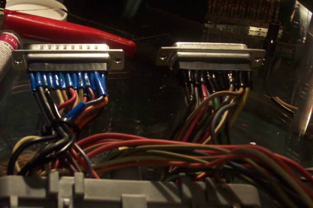

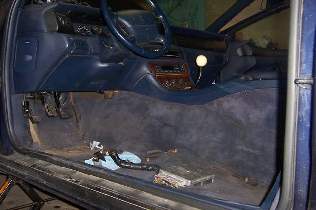

To fit the clutch pedal in, you have to move the ECM out from under the dash. I chose to mount it under the drivers seat, but am regretting it now. My 95 will get is ECM moved to the back electronics rack in the trunk. ALOT safer back there than under a seat that moves back and forth everytime someone gets in. The wiring harness has to be extended to reach to the new location, and for mine, required 850 feet of 18 gauge wire, 130 solder joints, and a few 25 pin D-Sub connector pairs. Pics also. (This is the most time consuming part of the job, except waiting for that beautiful new MMX driveshaft.)

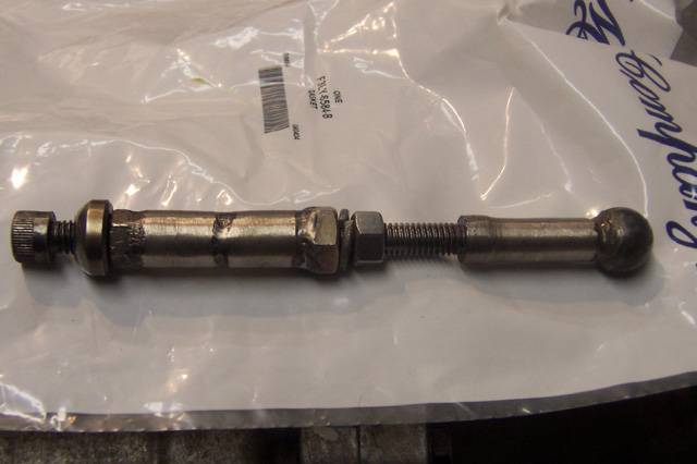

My shifter right now is a stock ford unit with a regulation size cue ball drilled and tapped to fit. (M12x1.75) The shift boot is out of a 97 camaro that my buddy did'nt need anymore so I swiped it from him. Your going to have to wire a clutch safety switch in to the starter circuit to keep unknowing people from wrecking the frontend. Believe me, a stock starter will pull a 4000 pound car pretty quickly. I found out the hard way.

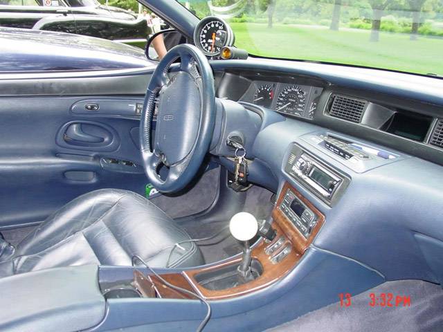

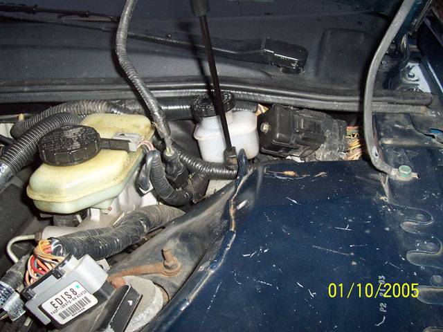

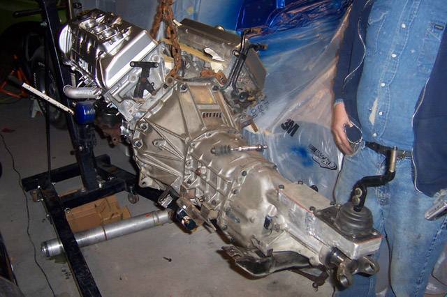

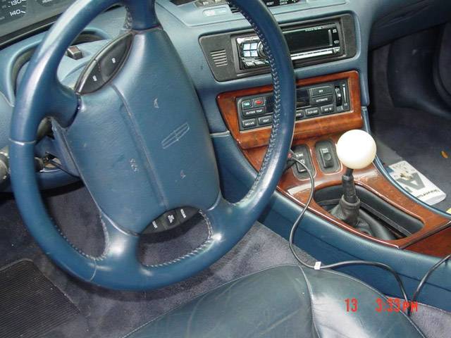

Sorry to cut that short, Here are the pictures. They could get alot more indetail soon, I'm gonna pull it apart in a couple of days.
Pic#
1 Stock T45
2 05' 3650 w linkage
3 Stock t56
4 My 94 before the mods
5 After
6 After
7 ECM location done
8 Engine and tranny ready to drop in
9 Master cylinder first test fit
10 M/C resivouir
The wiring harness will NOT fit anyway but angled like that so sue me if you don't like it.

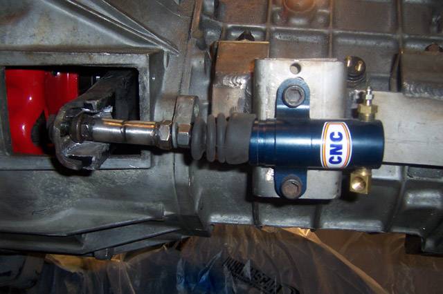

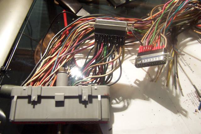

Posted by: 94m5
Pic#
1 Clutch linkage complete
2 Ugly handmade adjustable pushrod
3 Billet flywheel
4 McLeod Clutch
5 Custom adapter for Mc to pedal
6 Stainless slave bracket
7 Complete shifter extension
8 wiringharness mods
9 Wiring harness mods.
10 more wiring
11 more wiring
