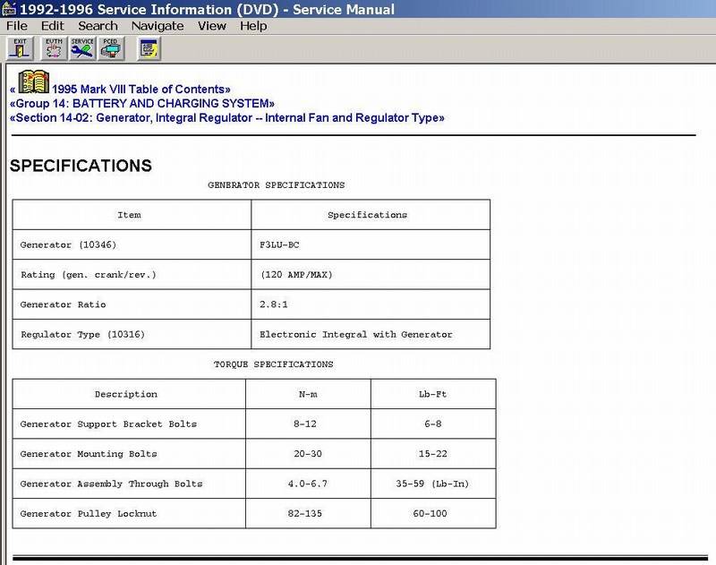

I need this information to show the judges at the next USAC or IASCA show I go to. I was once told it was a 120A alternator stock, but is that right?
Posted by: JoeyLincolnMK8
yeah it is a 120A!
Posted by: YouthKwest
thanks...now to find it in writing...any thoughts?

Posted by: driller
Quote:
Print this...
