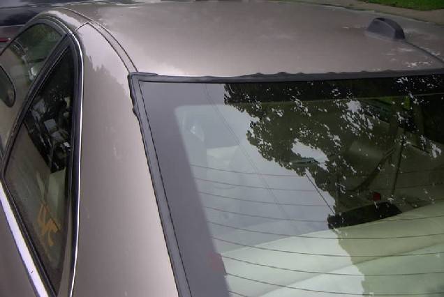

hey, i see alot of it, the seal all messed up, any tricks out there, to laying that baby down. mine is black, thought it was from the heat, but i seen a white mark, the same way, checked on a replacement at a local place, almost when to jail, before i got out of there, lol $375.00, for the rubber seal and labor. anyway, any ideals , thanks

I've been told by several people on this forum that you can tuck the outer flap into the crease. I've been meaning to do it but it's been too hot.

yes, it's hot here, also, 96 that's the best ideal yet, , i was thinking of some kind of glue, but didn't want to get it on the paint, thanks

i've used silicone sealant to seal mine down on the top.

I trimmed mine with XActo knife. Doesn't look to shabby if I may say so.
When I called around to see how much it would be to replace rear window, I got $1900 because the rear window is encapsulated, so the window and seal must be replaced.

I have tried to tuck mine in Pass side was a nice 5 min job went in easy.. Drivers side was a bitch and keeps trying to pot out... Can't seem to get the top dirvers side to go in...
The guy who put my windshield in told me to trim it as the piece has absolutly no practica funtion and will not cause any leaking.

tuck it in. it looks good. i did it with my 94 deep jewel green.
