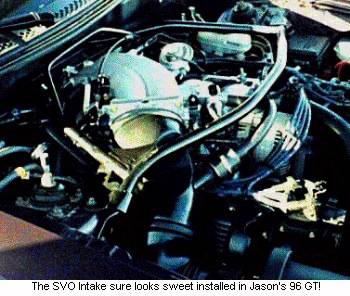

Posted by: evillally
Quote:
I don't know if Ford or any aftermarket companies make an all aluminum intake, but that is what I would want to replace it with.
The awnser is yes, they do produce all-aluminum intakes. Early 4.6 NPI stock heads used an all-aluminum piece. Alot of 5.4 swappers look for the early 4.6 fully aluminum intakes so they can weld an extra inch to make them fit the 5.4 engine and still clear stock hoods.
Ford also produced an all-aluminum SVO intake similar to the Bullit intake for NPI heads. The Bullit and SVO intakes give good gains, but may not be worth your budget for what you get for gains in the end.
As for PI headed 4.6's, Ford the Bullit intake that you can find on the "Bullit" Mustang.
Early 4.6L stock intake (91-96)
Bullit Mustang intake (99+):
Ford SVO(91-98):
