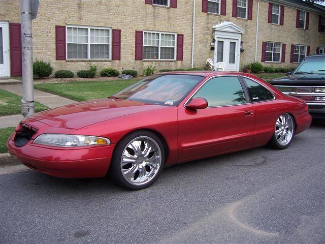

Where is your grill?
Posted by: brendangillespie
Quote:
Did have it at a paint shop to get painted, but now I've changed my mind and am going to get a custom grill from customcargrill.com.
