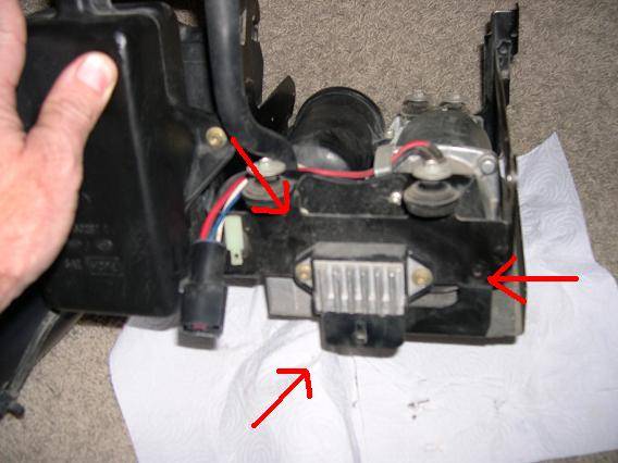

Hi gang, newbie here. I have a 95 Lincoln Conti that is having the same problem with the "Check Ride Control" message. At times you can hear the compressor, other times it does not come on. Sometimes the bags fill up, sometimes they don't. Really sucks when they deflate while driving down the road and everybody in the car becomes bobblehead dolls, complaining of whiplash and sea sickness.
Anywho....questions i have:
Where exactly is the air control shut off located and what happens when i do?
Where is the relay switch located and could that be the problem?

Where is the relay switch located and could that be the problem?.
Here's a pic:
This is the compressor/dryer assembly that should be located forward of the front, passenger-side wheel well. The relay is closest to the front of the car. I suppose that could be the problem, but I doubt it. Leaking bags cause the compressor to run longer and more often. This burns up the compressor sooner ran than later, a lot sooner.
