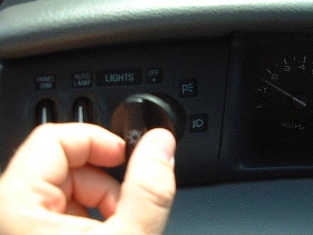

there are 2 dials on the left side where the knob for your headlights are. look for the one called "auto dim"?( i can not remember the acutal name) move the dial, up! (oh god i can not remember if it is up or down...lol i am all screwed up today!) either way you will figure it out. if that is not the answer, maybe something else is going on! just keep us posted.
Posted by: 1wykdmk8
You will see in that pic that it is called Auto Lamp. What you want to do is roll that switch down to disengage the Auto Lamp.....the farther it is rolled up the longer the lights will stay on after shutting the car down. If you roll it all the way down it will click (sorta, you will feel it not hear it) and that shuts the Auto Lamps off.

I turned off the auto lamps and the lights are still getting an electric current and staying on when the fuse is in and the engine is off...the mechanic mentioned something about the anti-theft system might be afecting them?? they tried changing out the lighting switch twice and it did not turn them off.
