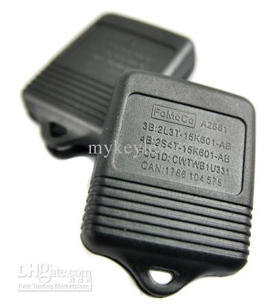

I have a 94 Linc TC and my transmitter FCC code is GQ43VT4T
I have a working transmitter but no instructions on how to program it to the vehicle. When I bought the vehicle it didn't have any transmitters. If you have instructions for any TC or Mark 7-8 I would really appreciate the help. I want to get a transmitter to work to make sure my vehicle is equipped with remote entry before I purchase transmitters for it.
